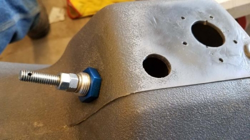

Brief Description:  Final lower tank preparation and fitting
The remaining holes in the lower tanks were reamed to size. The access cover area was smoothed flat. The holes were drilled for the access covers. All fittings were pulled through using the jig and safety wire. Aircraft gasket material was applied to all fitings. Tanks were cleaned and prepped for installation in to the ship.
Pulling jig for fittings

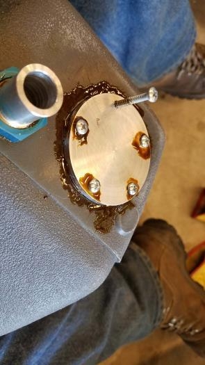

Final installation of acces plate for starboard tank

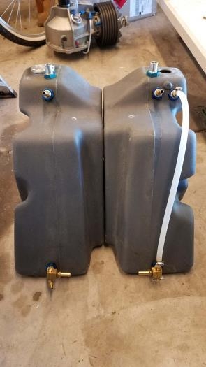

Fittings assembled, Ready to install in to ship.
