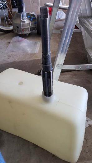

The auxillary fuel tank inlet was reamed and sanded to the proper size so that the inlet woul push in with some difficulty with the o-ring attached. The other fittings were pulled through and assembled. The auxillary fuel tank straps were made and attached to the seatpan.
Auxillary fuel tank inlet reamed

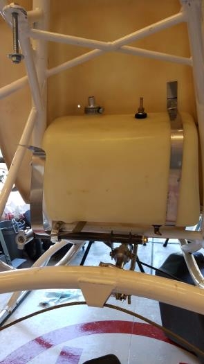

Straps drilled and fitted for auxillary tank
