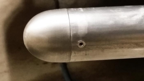

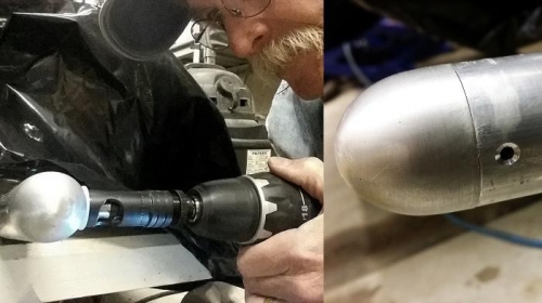

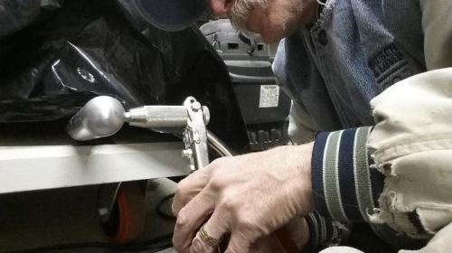

Installation of Skid End Plugs
A microstop with a 120 degree countersink was used to drill the countersink holes for the end plug countersunk rivets. End plugs were then pop riveted in to place with countersunk rivets.
Microstop With 120 Degree Countersink
Riveting End Plug
End Plug Installed
