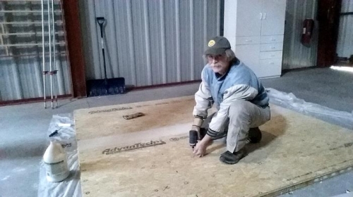

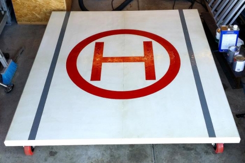

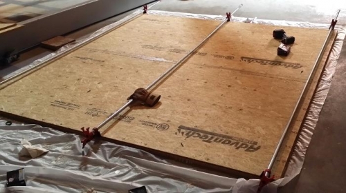

I finally found a use for 6 sheets of flooring underlayment material that I had sitting around from when I built my house. The 6 sheets were layed out 2 at a time and overlapped. They were all glued and screwed together to form a level service to build the Helicycle on. 5" casters were attached to the bottom so that the platform could be moved around the shop. Leveling jacks will be added later for leveling. No time is counted on this project as it really isn't necessary in the actual buld. I couldn't resist putting an "H" on the pad to simulate a heliport.
6 Sheets Of Flooring Underlayment Is Glued Together
Everything Is Screwed Together
Finished Movable Helipad
