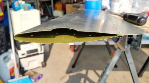

Brief Description:  Corrosion Proofing
The trim fins were taped on both ends and along rivet holes. Zinc chromate paint was thinned and poured in to each of the vertical trim fins to protect the inside of each fin. The vertical trim fin tubing was also painted with zinc chromate spray paint.
Zinc chromate protection
