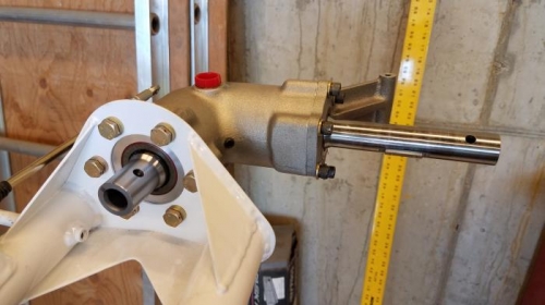

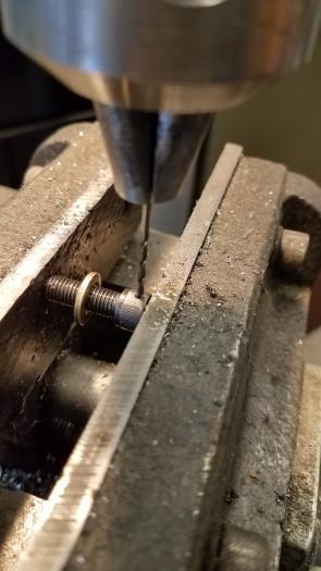

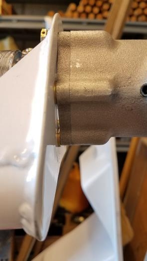

The tail rotor gearbox was installed. All holes were reamed in airframe with a 1/4" -0.001" reamer to ensure easy insertion of screws. The socket cap head screws were drilled with a 1/6" hole for wire ties later. The gearbox was eventually shimmed to align with the tail rotor shaft.
Tail rotor gearbox installed
Drill socket cap screw heads for wire tie
Shims for tail rotor gearbox
