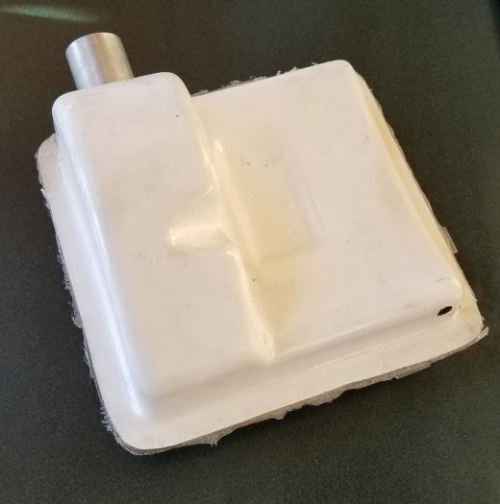

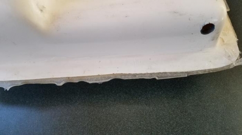

Brief Description:  Oil Sump Construction
The oil sump clamps were removed and the completed oil sump was inspected. The resin had oozed out around the piece indicating a good bond. The sump was water tested and had no leaks. Initial sanding was done on the part to clean up the edges and prepare the body for painting. A 1/8-27NPT tap was ordered so that the cap assembly could be installed next.
Good bond at edges

Fuilly assembled sump ready to prepare for painting
