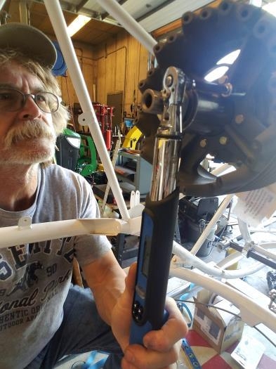

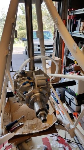

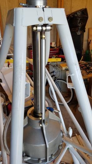

The transmission alignment was checked one last final time before drilling the second hole for the transmission mount with a #4 center drill. The transmission lift strut was assembled and installed per the new instructions. The pulley was set in place and the bolts were tightened to 35 inch/pounds.6
Transmission mount ready to drill
Transmission lift strut installed
Torqe pulley bolts to 35 inch/pounds
