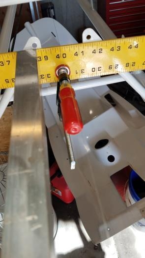

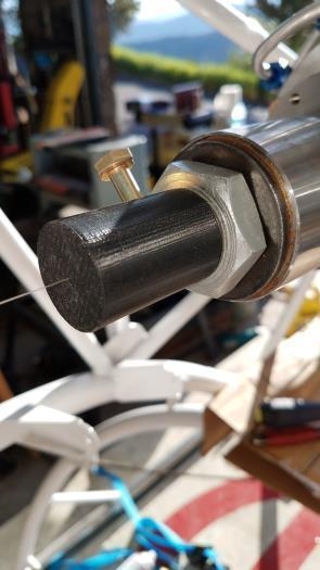

Transmission Alignment
A 3D printed jig was made for the transmision housing and the hole at the tail rotor so that a fishline could be installed for alignment of the transmission accounting for the 1/4" offset needed due to 400 FT/LBS torque in the transmission.
Fore 3D printed jig
Aft 3D printed jig
Alignment of the transmission
