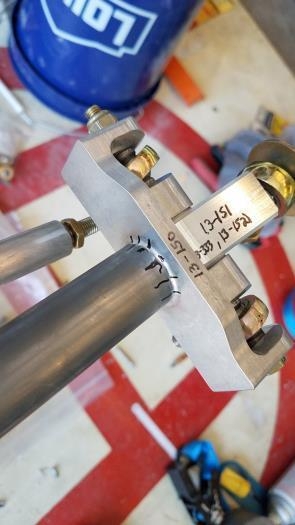

Control Installation
Today was mainly spent lining up the cyclic to the mixer assembly prior to drilling the holes in the cyclic shaft ensuring that the cyclic and mixer assembly were 90 degrees apart.s
90 degree alignment of cyclic to mixer assembly
Cyclic shaft and mixer marked prior to drilling
