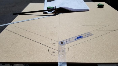

Trim fin layout
Trim fin layout

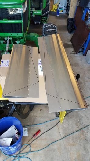

Trim fins marked
Trim fins marked
