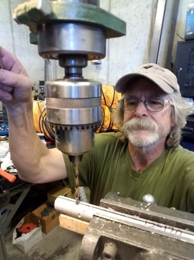

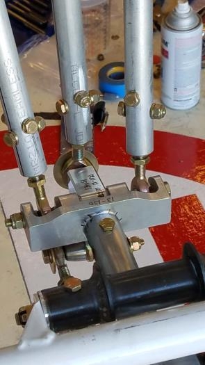

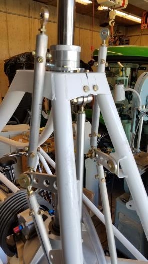

Work was done on the push/pull rods for the cyclic control. Rod ends were inserted and drilled at 90 degrees and then installed in mixer assembly. The walking beams were finalized and installed and the short push/pull rods were attached.
Drill control rod ends
Push/Pull rods attached to mixer assembly
Walking beams attached
