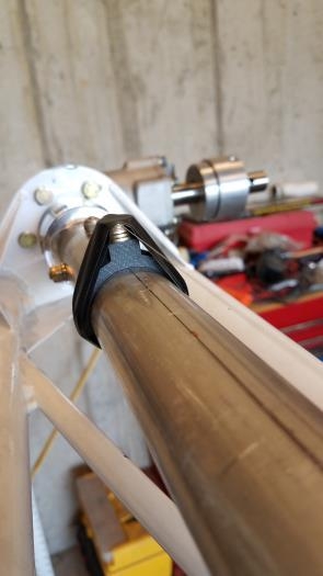

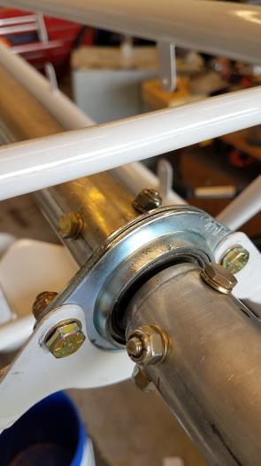

Brief Description:  Tail Rotor Shaft Construction
Many hours were spent fitting all the tail rotor shaft segments in place prior to driling the holes. This is a tedious process and nerve wracking knowing one small error with drilling could ruin lots of parts. A string line and block were set up to check the straightness of the shaft. Tomorrow will entail final setting of the tail rotor bearing assembly housings once everything is perfectly straight.
Holes drilled for tail rotor shaft
String line set to check shaft alignment
