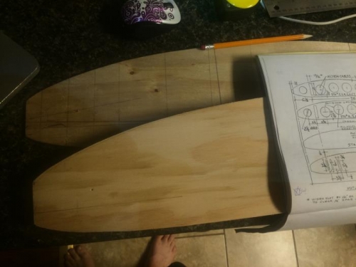

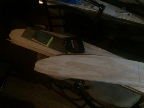

Brief Description:  Rib Finish Work: Tip and Tail Cuts
Modified "template" rib that I used for router, to include the leading edge and trailing edge tip cutouts (1/2''' and 5/8'' respectively). I then used that to mark out the actual ribs and then cut them with a fine handsaw, some sanding will smooth the edges and get them back to standardized.
