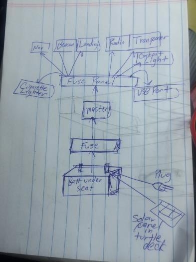

Brief Description:  Rough plan for electrical structure

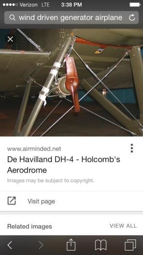

Sketched rough electrical system plan. Using small sport vehicle battery under seat, fan generator, small solar panel in turtle deck to supply power for radios, lights, etc. Found good source for LED lights that will work for VP-1. Will be refined as needed.
