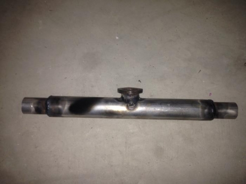

Built intake piping
Built intake piping

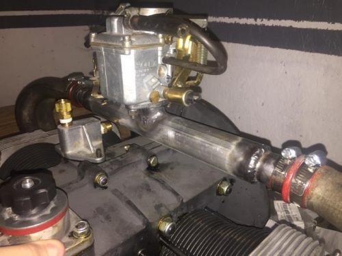

- used new pieces for exhaust tubing
- welded so fits into rubber connectors on intake castings
Repurposed carb mounting flange to shorten and attach to new intake cross pipe
- drilled hole in center of cross-pipe
Welded all

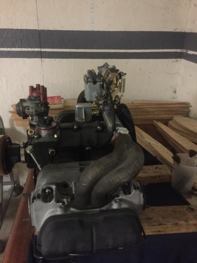

Mounted on engine
