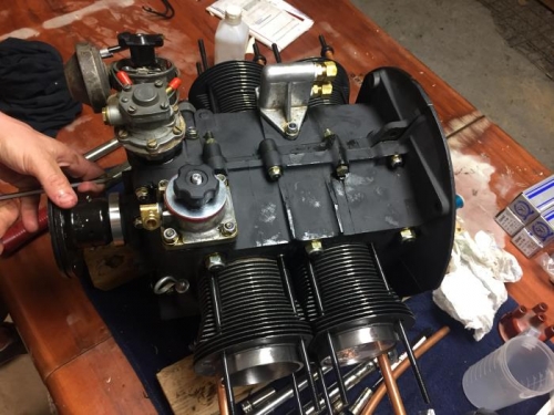

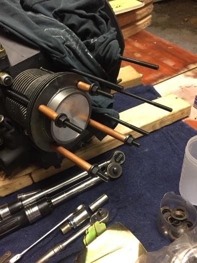

installed studs, checked deck height, installed cy
Installed cylinder studs with permatex

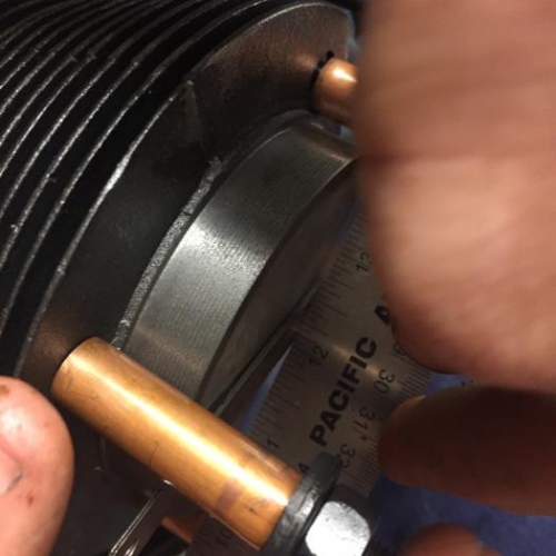

Checked deck height on pistons -- all in spec 0.040-0.080
#1 0.049
#2 0.060
#3 0.053
#4 0.057
Installed barrels and pistons using holders untill heads come in fromt he shop....delays...
