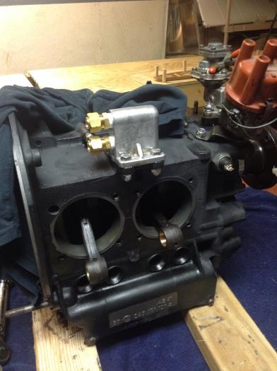

Brief Description:  Installed oil cooling tower
Installed oil cooling tower, had to drill outer holes to accept 8-1.25 bolt (wanted to keep all the hardware standard). Installed brass plumbing fittings to install "u" untill I decide if I need a remote cooler, and which one I want to go with. Parts arrive for heads soon, engine will be nearing completion then.
