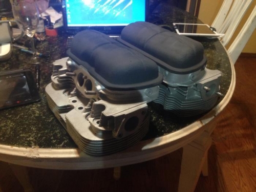

Painted Head Covers, will be baked in oven to fully cure.

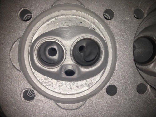

Recieved Heads back from Exton Automotive Machine Shop, very nice and clean, defects easier to note.
Will be mailing out for Al welding on the 2 small crack areas in the valve seat areas, and welding/flycutting on pounded out cylinder as well as stud removal and work on threads for exhaust and intake flanges.
