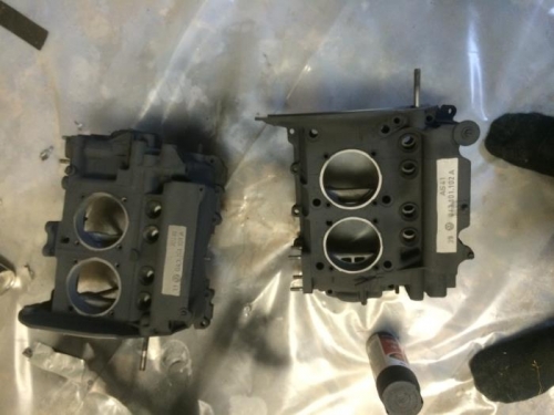

Brief Description:  Case work, internals arrived
Painted Case with Rustoleum Engine Enamel (Flat Black) with thin coat, and oven baked for 4 hours to cure paint.

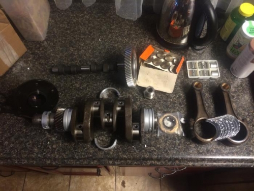

All parts arrived from EvwParts and began crankshaft build up...unfortunately it seems they sent me the wrong main bearings so I will be sending crank and bearings back to ensure they did it all correctly.
Prop hub arrived from Great Plains Aircraft. Simple shrink fit prop hub, with the addition of an oil seal that fits in the front of the case w/no extra machining necessary, once crank is back I'll be heating it up and pressing it on, bolting/drilling/cotter pinning.
