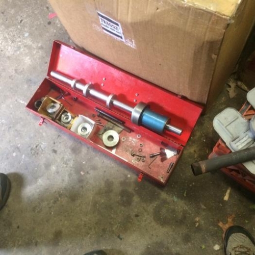

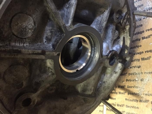

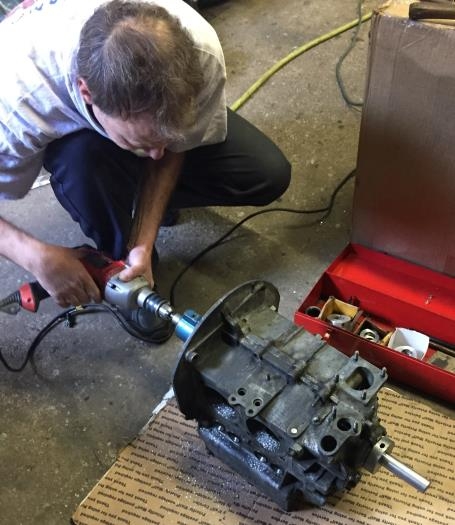

Align Bore and Thrust Cut
Trip to eVWparts in Severna Maryland for align bore and thrust cut. Align bore +0.04'', Thrust cut # 1 to 21mm.
Camshaft apprasied and rejected, will need replacing.
Crankshaft apprasied and needs machining on first bearing race. Remachined crank will be purchased using current one as "core".
