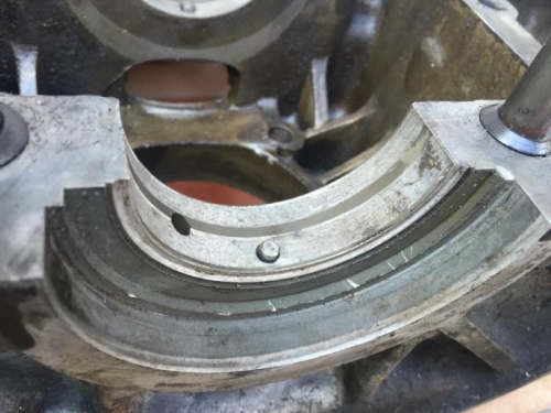

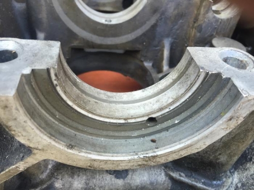

Evaluated condition of used VW1600cc
- thrust bearing journal pounded out
L case: min. 20.5mm
R case: min. 20.4mm
Main Journal: 55mm (i.e. standard: never line-bored)
Crank: 55mm (i.e. never turned)

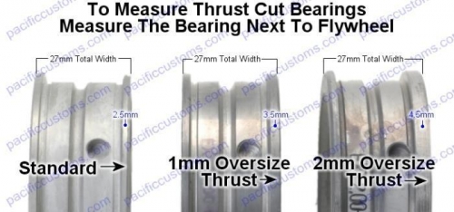

Plan: (1) Thrust cut to min. 20mm or MORE; order 2mm oversize thrust bearing & cut to fit
