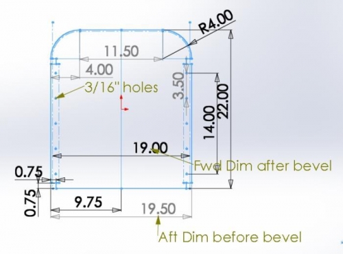

0.75
F7
Edited Model of FIrewall F7 to add bevel & side ho
Edited Model of FIrewall F7 to add bevel & side holes
