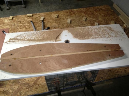

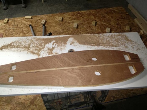

Root Ribs-trimmed outside & inside
Root Ribs
- trimmed mahogany plywood outside edges with router pattern bit
- drilled 1/2" holes for pilot bearing in pass-thru, front spar opening & rear spar opening
- trimmed plywood on inside openings (pass-thru, f&r spar openings)
