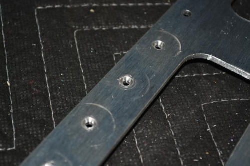

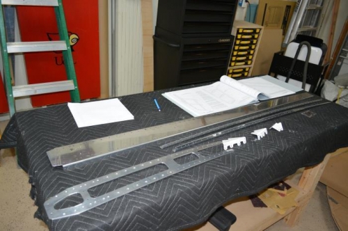

Been on vacation the last few weeks and took the -12 down to Atlanta for a family reunion and to give airplane rides…time to get back to work on the -10. Now I remember how much I L..O..V..E deburring. Actually, it’s not too bad, it’s just my hands are out of shape and start to cramp up. I started working on the vertical stabilizer (section 6-1), where I completed all the match drilling and countersinks. A lot of holes, assembly, disassembly, and reassembly, but that is part of the process. Looking ahead, when it comes to the skin, I see I’ll need to start bucking rivets. I’ll need a lot more practice before I ready to do that on the real parts.

parts drilled and deburred
countersinks complete
