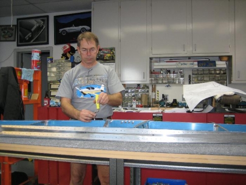

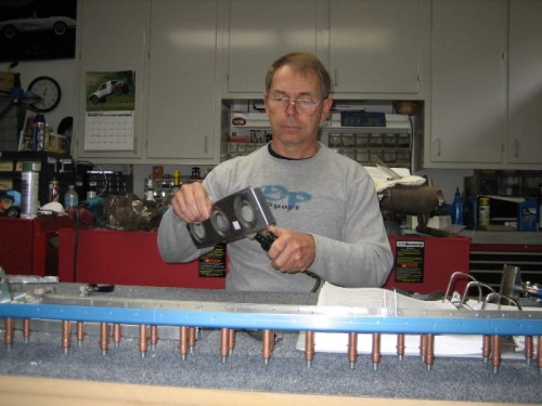

I started the day by disassembling all the horizontal stabilizer parts, deburring all the holes and smoothing the edges. I then setup my pneumatic squeezer to dimple the spars, ribs and bulkheads. I will do the skins later. I double checked the plans, checked all the parts for straightness, checked the flanges for square. Now I was ready for priming, so I made sure I had the materials ready. I'll wait til tomorrow and spray outdoors during the peak heat of the day
Deburring holes
Deburring holes
Deburring edges
Deburring edges
