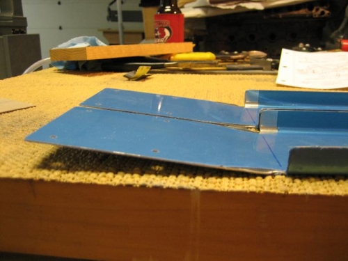

Brief Description:  Front spar bends and machine countersink
With the modifications complete, I now had to bend the 6 degree bend in both HS-702's. I used the same method as for the reinforce bars using wooden blocks, but instead of a mallet I used a short piece of 1x6 hardwood anleaned it up against the HS-702 spar channel right at the bend line. I applied pressure until I had the 6 degree bend. I dimpled the 4 holes where the HS-702 spars butt each other. I had to machine countersink the reinforce bars.
6 degree bend in HS-702
