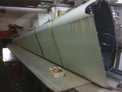

Brief Description:  Top Skins

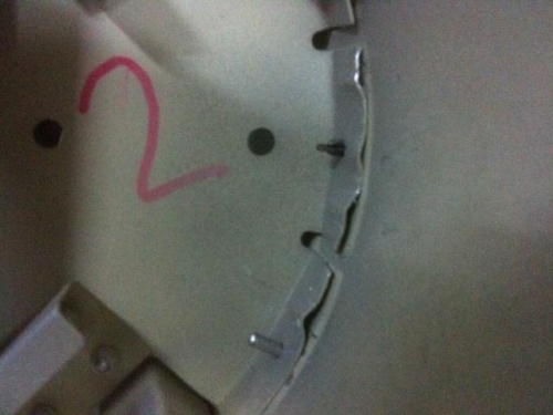

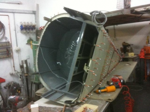

Fit and rivet the skins in place - this is a big day's work! there were a couple of high points on the lower corners of ribs - difficult to see until they are finally riveted in place. There is also some surface marking from the machine / cnc punch of the large top skin - should be able to fill and sand flat - pitty! the sequential clecoing was a good pointer from Gareth when he did my inspection earlier in the week. Next fit the front cabin skins.
Looks like drunken sailor
Rib interferance
Rib interferance
All nice and flat
All nice and flat
