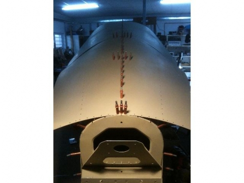

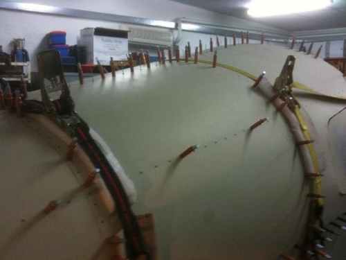

Brief Description:  Fit skins
Yesterday and today - spent quite a long time fitting / refitting skins. Gareth showed technique Cleco from top to bottom - keeping lines the same. sitting quite nicely now and started rivetting. I had rivetted the luggage firewall backing - had to drill out - was not happy with crinkles. will re rivet this when the rest of the skins are in place
Start upper
Start upper
Straps to keep skins flat
