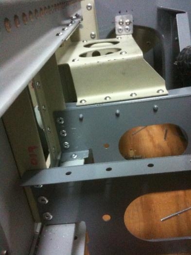

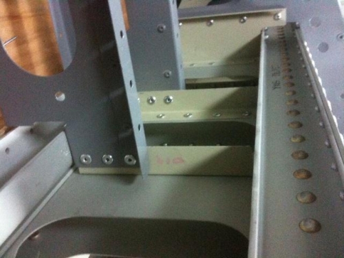

Rivet fuselage components together. This is a tight fit - and getting the rivet gun in -not easy.

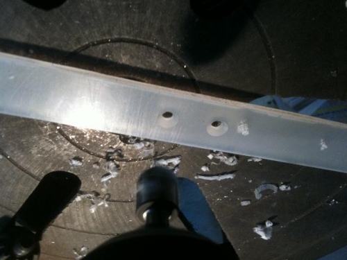

Had to fabricate a small bracket for the autopilot asbly as the cutout on the rib doesn't allow the rivnut position to correspond with the bracket. Countersink seat slider angles and fit rear stops. will have to drill some rivets out on the centre console to accommodate - should have been told to leave these rivets out!
rivet main spar to fuselage
