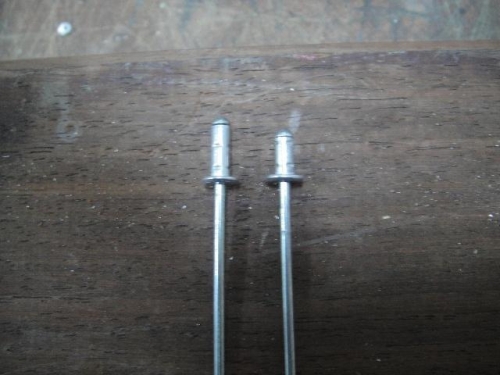

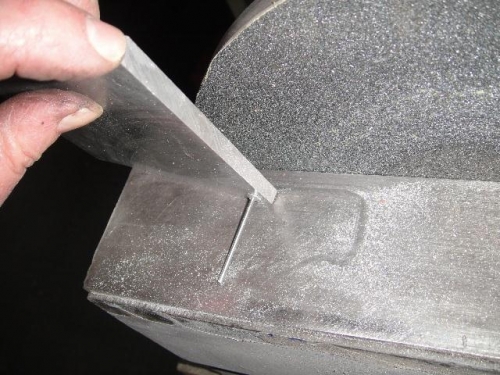

Brief Description:  Rivet Shortening
To make shorter rivets - as used in some of the thin sections - ie trim tab and near leading edges - I used an apropriate thickness of aluminium plate. Remove the rivet mandrel . Drill hole same size as rivet and with a disk sander, grind off the excess.Replace the mandrel. It saves the fingers and all the lengths are the same.
