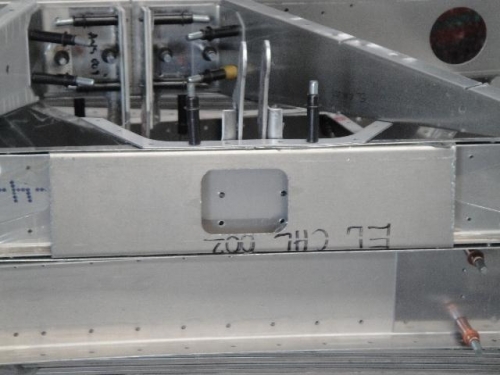

Went to Factory asked Mike Blythe about elevator - some of the diagrams are not accurate - had to redo some of the riveting and reposition support as per factory build. Past week priming and preparation. Mike said OK to use 2 stainless rivets - rest aluminium Lower bolt and upper SSteel on control horns will be fine
Support not fitted correctly

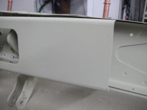

Factory example
Factory example

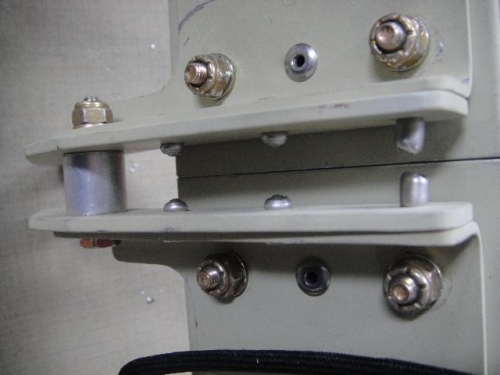

Stainless or Alu rivet?
