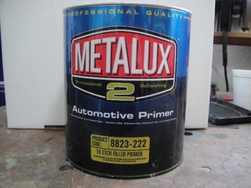

Paint Primer
Have decided to prime - prior to assembly.
General opinion is that the aluminium doesn't need priming.
If the ship moves to the coast, I think I would feel more comfortable - Belt and braces!
Factory recommends Chemspec 8823 - a single step self etch primer -
Phoned the factory in Durban - there is also another 2k 8051/ 8052 primer - has more acid and etch. This is a two part catalytic paint.
If prepared and cleaned properly the single phase should be fine.
Factory uses benzene as a degreaser
Metalux primer
