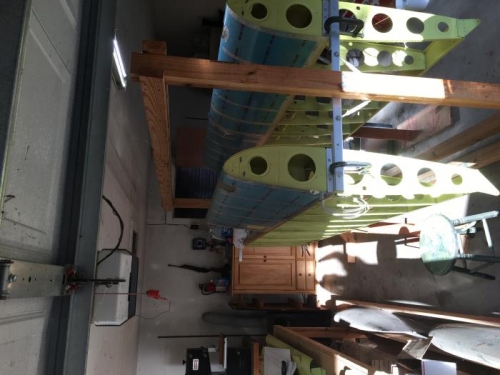

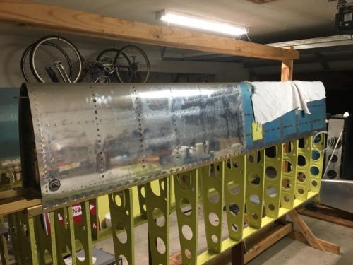

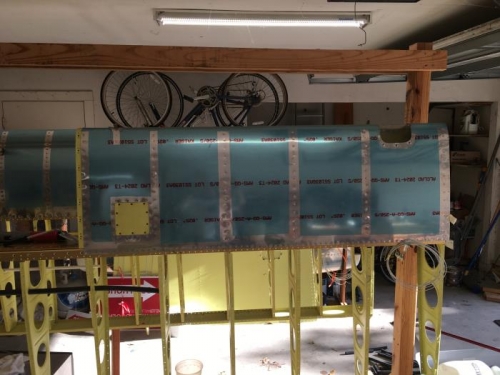

Squeezed the rest of rivets for the leading edge.
Fitted the fuel tank. I had to file a little tiny bit to get the edges flush but the joint is really impressive. Kudos to Van's predrilling.
I did have to drill oversized holes in the very inboard tank attachement bracket to get the screws in. All the other ones fit perfectly.
