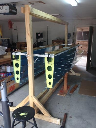

Started off by attaching the bottom bracket to the wing frame so everything is squared up and stable.
Put the bottom wing skins on the frame. Ended up running out of silver (3/32) clecos so I took them from the top skins where I could (since they were already drilled) Ordered more cleco's.
I have been using foam ear plugs which work okay but hurt my ears. I had an old set of noise cancelling headphones to which I attached the iPod nano. Worked really well at cancelling the shriek of the air drill.
Spent a couple hours drilling out everything.
After this it is off to study for my BFR in the Mooney tomorrow. Also have to work on some of the commercial manouvers, esp the chandelles and lazy eights.
Jamming and drilling
All the clecos
All the clecos
