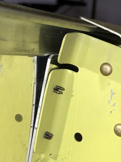

Brief Description:  Longeron Bending III
After some head scratching I loosened everything up and then started re-clecoing the skins from the bottom up one row at a time. That way everything popped into place and I was able to get the longerons snug up against the bulkheads and gear towers.
I had cleco'ed stabilizer attach bar in place which I had to remove. I was a little bit panicked that it went past the end of the fuselage until I read the instruction about having to trim it.
Hard time fitting
Hard time fitting
