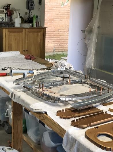

Prepared the F886 rudder stops, the 810/11/12 angles. Separated deburred, polished, and filed all the parts. Prepared the 812 bulkhead.
I did some of this out of order with the manual as I was waiting on primer and painting cups.
Drilled and dimpled the 812 bulkheads.
Prepped the 811 bulkhead, separated and prepared the stabilizer attach bars. Deburred, polished, and filed the bars.
Final drilled the 807/808/809 bulkheads.

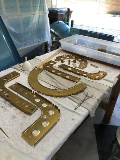

Cleaned, acid etched and alodined the bulkhead parts and the stops/angles/bars.
Drilling bulkheads
Alodined
