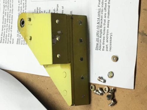

Drilled out all the rivets holding the mid-wing aileron attach bracket.
Will comply with SB 2016-03-28 by installing two doubler plates on the inside of the spar and then re-riveting the bracket onto the back of the spar.
