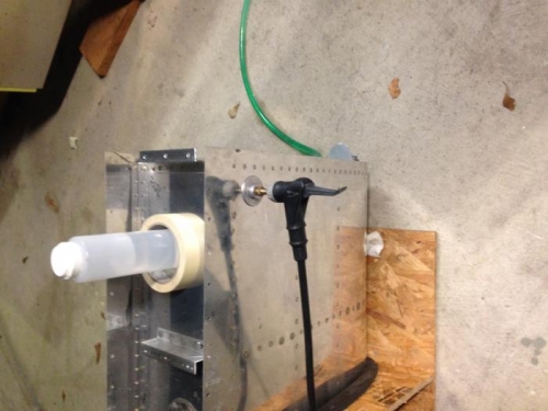

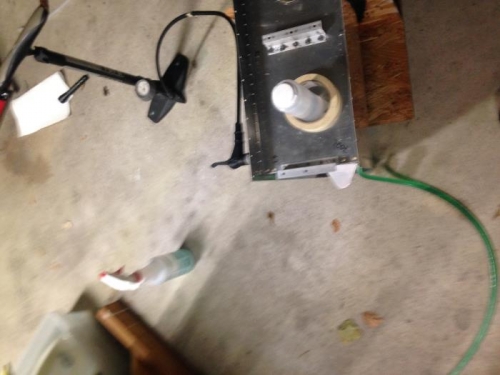

Brief Description:  Fuel Tanks - Testing
Pressure tested the fuel tanks. Both have minor leaks. Thankfully, both baffles are fine. The left fuel tank has a giant leak around the fuel drain fitting. Pretty sure I applied sealant there but will remove and reseal. The right tank has a pin-hole leak around the very front of the fitting at the front of the tank. I will remove the access plate and re-apply sealant around the front of the tank.
