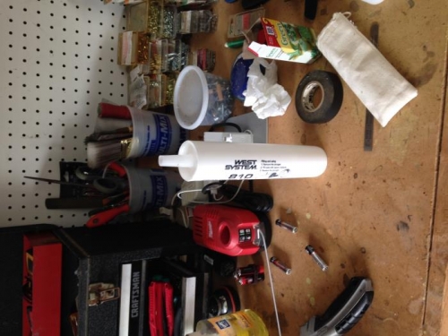

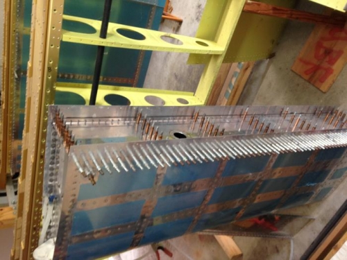

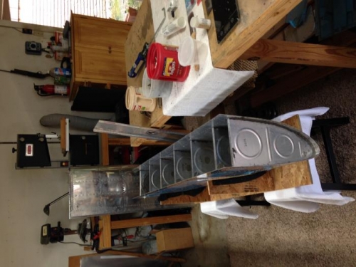

Installed the baffles on the left and right tanks. Began by cleaning and scuffing the back. I bought two fillable tubes for the sealant. They are like the tubes for caulking at Home Depot but empty. They were great for creating a continuous bead of sealant in the correct position for the baffles.
Marcey helped me cleco everything into place.
Did both tanks. Will let them dry, install the two fuel senders, and then pressure test.
Cleaning the tanks
Cleaning the tanks
Tube for sealant
Tube for sealant
Cleco'ed
Cleco'ed
