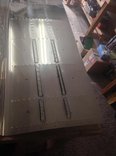

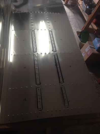

Put the left tank stiffeners in.
I am doing this the way I did the first time. Put down the sealant in a line around the rivet holes, then cleco the stiffeners in place. I will come back and back rivet them in place at a later date after all the sealant has hardened.
Much easier, faster, and less messy then trying to cleco, seal and rivet at the same time.
