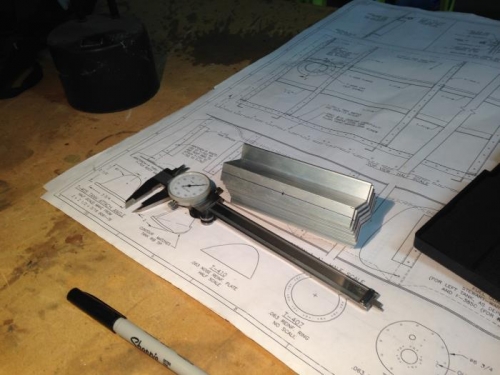

Brief Description:  Fuel Tanks - Z Brackets
Measured all the z brackets top and bottom. Going to do them a little differently than Van's order. I am going to drill out the five holes attaching the brackets to the ribs/baffles and leave the other end blank. I will drill the holes for the spar attach platenuts after the tanks are mostly done and fitted to the wings. Then attach the platenuts and finally rivet them to the tank as the final step.
