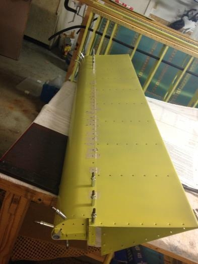

Ailerons - Left Riveting
Back riveted the top skins to the spar. Tried to use the large back riveting plate but it didn't work too well. Ended up putting the aileron on wooden blocks and using the narrow back rivet plate.
Back riveted top
