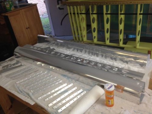

Ailerons - Etch and Alodine
Acid etched and alodined aileron parts.
Went to Lowe's and bought a 10' section of gutter which I cut to 6'. Used that to hold the spars.
The wing skins and leading edges I soaked with a hudson sprayer over a drain pan.
After etching
After alodine
