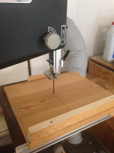

Made a sled for the band saw out of scrap wood. Feeding things through by hand was resulting in potato chip looking pieces.

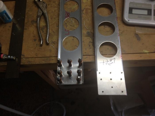

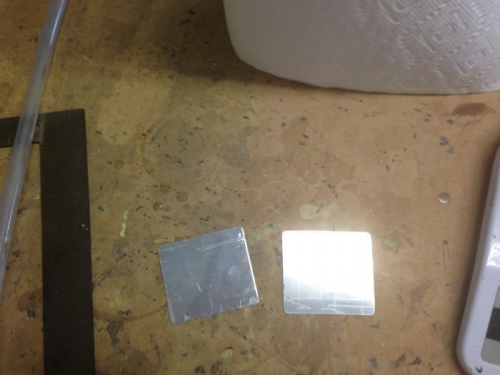

Cut two reinforcing plates, match drilled, and countersank the holes.
Bandsaw sled
Plates
Match drilled
