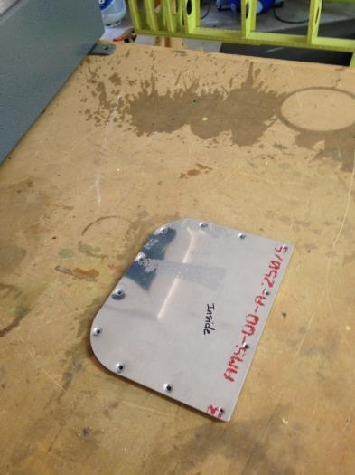

Drilled, dimpled, and deburred the inspection plates for the wings.

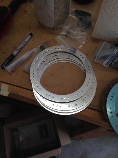

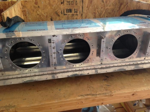

Drilled the holes for the nutplates on the new tank access panels. Dimpled and deburred the holes in the tank rear baffle. For the reinforcing rings inside the tank, countersank all the holes. Cut a notch in the ring to allow me to slip it into the tank.
Inspection Plates
Inspection Plates
Tank rear baffle
Tank rear baffle
Tank rings
Tank rings
