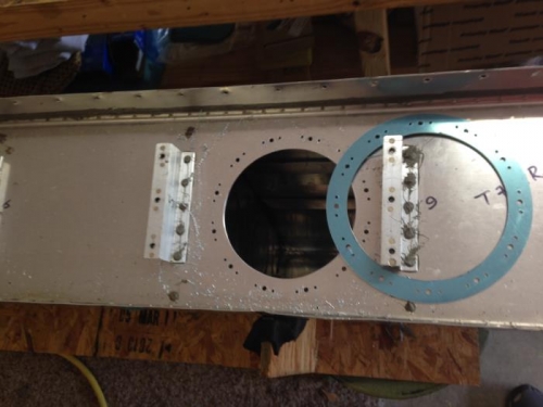

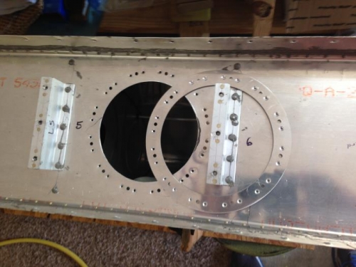

Prepared Tank seal plates
Prepared all the hardware for sealing the tanks. Countersank the reinforcing brackets and dimpled the holes for the nut plates.
