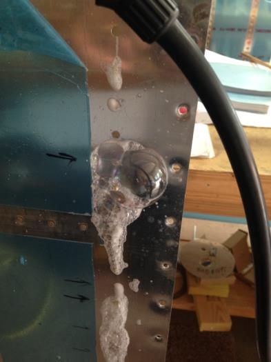

Brief Description:  Tank Leaks
Found the leaks in the fuels tanks. Rivets in the skin along the back baffling plate are leaking. There are two areas in the left tank, and one area in the right tank. This will necessitate opening the tanks back up to reseal them. But at least I am very happy I figured out what is going on.
