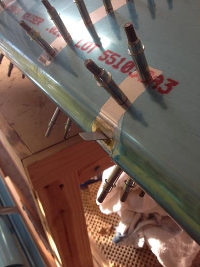

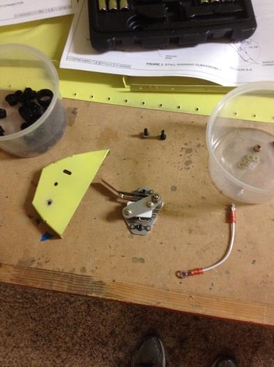

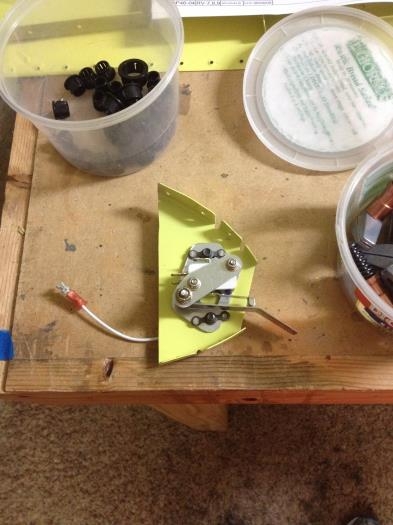

Assembled the stall warning system. I realized all of a sudden that all this primer would prevent the proper grounding of everything so I had to scrape some of the rivet/screw down to bare metal with a scotch brite pad.
Tested the connectivity and all seems good.
Assembled
Mounted
Fitted
