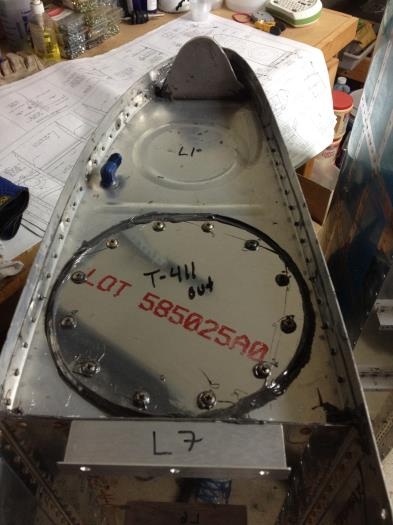

Sealed Access Plates
Sealed the two access plates. Used a bead of sealant above and below the cork gasket.
So cold outside will have to wait until the weekend for the leak test.
